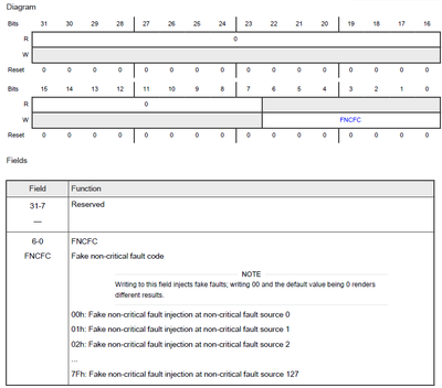

    If SAF and SPD aren't used in the application, is it possible to inject a fault in FCCU in order to test the reactions for these kind of faults?
    I found the Non-critical Fault Fake(NCFF) register in the Reference Manual. Will fault be injected if write a value in this register?

SAF and SPD inject faults into peripheral hardware via the EIM (Error Injection Module).
In contrast, the NCFF register injects faults directly into the FCCU, without affecting peripheral hardware.
If your goal is to test FCCU fault handling independently of peripheral fault sources, using NCFF is appropriate.

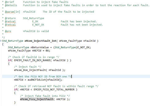

By the way, SPD/SAF also use the NCFF injection:
