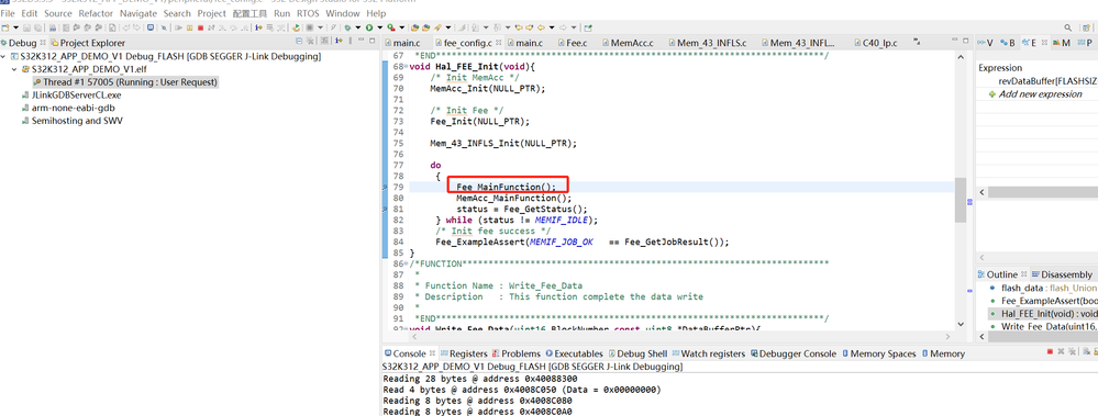

Hello, I'm encountering an issue with the FEE initialization process on the s32k312. My program seems to be stuck at the Fee_MainFunction(), preventing me from proceeding with further operations. I've attached my project code. Could you kindly review it for me?

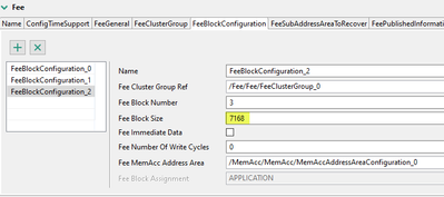

I imported your project to S32DS and I can see following error message in the configurator:
Issue: The total size of blocks is too big. They do not fit into the cluster group FeeClusterGroup_0. Increase the size of the cluster or reduce the size of blocks.
Level: Error
Type: Tool problem
Tool: Peripherals
Origin: Peripherals
Resource: Sources
Information: The total size of blocks is too big. They do not fit into the cluster group FeeClusterGroup_0. Increase the size of the cluster or reduce the size of blocks.

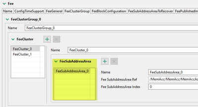

So, you need to reduce FeeBlockSize (I can see in FeeBlockConfiguration_2 that FeeBlockSize is 7168) or you need to increase the size of cluster. The size of cluster can be increased by adding another FeeSubAddressArea.
I believe that it will work as expected if you fix this error as described above.
