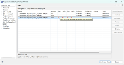

I installed SDK Version 2.0.0 and Version 2.0.3 in S32DS 3.5
But there is an error tip "SDK is missed".
How to fix this issue?
Thanks!

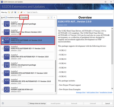

Hi @xierxiaofeng
First of all, RTD 2.0.0 and 2.0.3 were developed and tested in S32 Design Studio for S32 platform version 3.4, so we cannot guarantee that they will work correctly in other IDE versions. We suggest using them in the IDE version they are intended for.
Additionally, S32DS does not allow more than one RTD version of a device family to be installed.
Sorry for the inconvenience.
