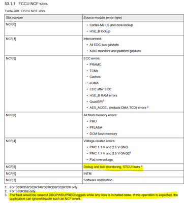

[NXP] There is no EIM that would allow to inject voltage related errors. The list of supported EIMs is described in HW reference manual (S32K3xxRM_Rev7.pdf, section 51.1.2 EIM channel mapping).
2. After successfully injection of error DCMROD4 register bit number 26 high for VDD1P1_GNG_ERROR?
[NXP] After injecting the fault the NCFS4 bit in FCCU status register (NCF_S0) is set (no bits are set in DCMRODn registers).

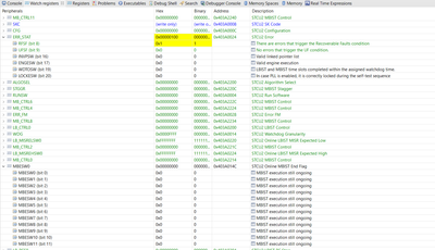

But now while debugging observed after FCCU, NCF_5 fault injection DCMROD5 bit 9 and 11 is in high sate for all the NCF_5 fault injection which is available for S32K312. is it expected behavior? if yes, then why? please see the attachment.
2. Why for NCF_5 always above-mentioned bit of DCMROD5 is high, for all the DCM_NCF which is available for S32K312?
3. After Injection of NCF_5 observed STCU2, Register ERR_STAT bit 1 is always high for all the NCF_5 related FCCU fault injection? please see the attachment.
4. What is the co-relationship between NCF_5 (FCCU) and STCU2 register ERR_STAT.? I tried to refer RM but unfortunately not able to understand (55.8.3). please see the attachment.
5. After injection of error using eMcem_InjectFault(EMCEM_DCM_NCF_5_FAULT_MONITOR0); API, it is returning E_OK, Also FCCU ALARM is generated and NCF_S0 bit 5 is in high state. so, I am assuming FCCU fault is injected successfully. is my understanding correct? please see the attachment.
6. Is NCF_5 available for STCU fault injection?
7. If above mentioned point is correct then how we can inject NCF_5 fault of debug and test monitoring.?
    [NXP] Yes you are right, I see the same in the tests. The NCF_5 has a special HW behavior. When injecting the NCF_5 faults there are also simultaneously other faults set by HW (EMCEM_DCM_NCF_5_STCU_NCF,  EMCEM_DCM_NCF_5_LMBIST_USER_CF). Here is the table which faults are reported by eMcem alarm handler when injected:
    [NXP] NCF_5 has a specific HW behavior.
    [NXP] Yes this bit is set as a result of NCF_5 injection.
    [NXP] As described in HW reference manual, NCF_5 includes faults for STCU2 so the bit in STCU is set as part of fault injection.
    [NXP] Yes your understanding is correct.
    [NXP] You can call this API:
    retStatus = eMcem_InjectFault(EMCEM_DCM_NCF_5_STCU_NCF);
    retStatus = eMcem_InjectFault(EMCEM_DCM_NCF_5_DBG_ACTIVATION);
    retStatus = eMcem_InjectFault(EMCEM_DCM_NCF_5_FAULT_MONITOR0);
    retStatus = eMcem_InjectFault(EMCEM_DCM_NCF_5_FAULT_MONITOR1);
