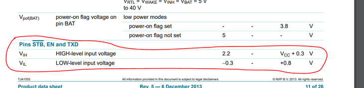

Senlent
Hi@rexoplans
1. Have you configured and initialized the pins correctly?
2. If everything is configured correctly, then you can use tools such as an oscilloscope or logic analyzer to test whether the TX output on the MCU side has the correct output.
3. If the TX on the MCU side is normal, then solve the problem of TJA1055. Usually the STB and EN pins should be controlled by the MCU side.
Input requirements for STB and EN pins

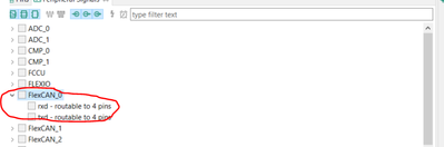

rexoplans
Hello, my pin numbers are correct, but I'm not entirely sure about the pin configuration. Here's the situation: I'm observing output on the RX pin of the receiver card through the oscilloscope, and my signal appears correct. Shouldn't I not be seeing a signal if the transceivers weren't activated? My Tx pin configuration seems correct; I'll check on the configuration of my RX pin. In fact, I'll leave the configuration I've made below.
