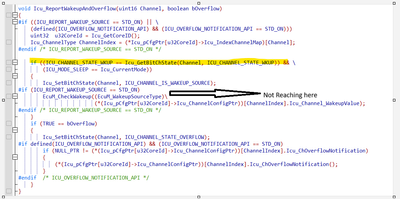

Problem:
We are able to generate the interrupt on ICU Wakeup channel configured as a Wakeup Capable once we send NM Message. We could execute  the Icu_ReportWakeupAndOverflow(); also, but we are not able to Execute Ecum_CheckWakeup(); because the channel state is always  ICU_CHANNEL_STATE_IDLE (we are making ICU Mode to sleep while triggering sleep for ECU)As the channel state is Idle, and the ICU Mode is Sleep, the condition is getting invalid to execute EcuM_CheckWakeup();
Please go through the below Executing sequence once we receive the interrupt for ICU:

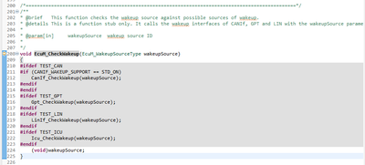

Are you able to share your main.c to see if all of the configurations shown in the picture are done correctly?
Just keep in mind that the EcuM_CheckWakeup function is a function stub only. You need to have enabled the respective module (in this case ICU) for the function to work correctly (or call Icu_CheckWakeup directly)

Point-2 We have enabled the EcuM module and calling Icu_Checkwakeup() inside EcuM_CheckWakeup(). But the problem is we are not able to trigger the EcuM_CheckWakeup when there is a ICU Wakeup Event. (because the channel state is RUNNING which is not allowing to call EcuM_CheckWakeup())

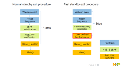

Will the Functional reset happen automatically while waking up after going to Normal Standby Mode for the Microcontroller?
Because I see many posts where they are referring as FastStandBy Mode and providing the address of Reset handler (Same as example code). But no idea on how the microcontroller behavior will be after Normal Standby mode.
4,975件の閲覧回数
Julián_AragónM
Hi @harsh_95,

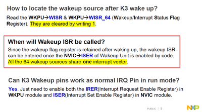

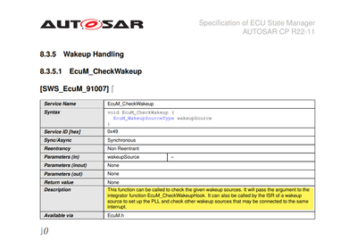

Point-2 I believe this comes from the AUTOSAR specification since it is established that the function can be called from a wakeup ISR, but the K3 family shares the same ISR for all of the wakeup sources:
You can call the EcuM_CheckWakeup in the fast standby user defined boot address, so it is the first thing after exiting standby:
Let me check the functionality with EcuM module for checking wakeup sources with the internal application team, I will get back with you as soon as I get an answer.
Point-3 You can refer to the previous picture. After normal standby exit, a functional reset will be asserted and the MCU will run the reset handler back into the main code. When using fast standby exit will skip sBAF and HSE initialization and will run a user defined boot address so you can handle higher priority wakeup sources.

Regarding Point 2, we could able to resolve the issue after invoking the proper Sleep and wakeup sequence of ICU. So now we are able to call the EcuM_CheckWakeup() whenever there is a wakeup interrupt detected.

Julián_AragónM
Hi @harsh_95,
After normal standby exit, the MCU performs a reset. If using fast standby exit, you can implement a reset handler after your user defined boot address, as shown in the bottom of the following image:

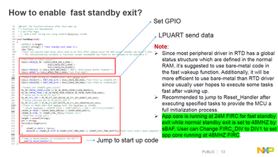

Could you clarify if you are using fast standby exit? If so, you need to implement the reset handler as shown in my previous response.
4,856件の閲覧回数
harsh_95
Hi Julian,
Yes, we are using Fast standby exit.  Below are the configuration screen shot. The problem we are facing is we are not able to jump to the configured Boot base address.
As per the configured Boot base address, we were trying to jump to application after wakeup, but we are not able to. (Just for understanding as of now, we are trying to jump to main(),  but we want to jump to reset handler)
We are using bootloader and Application.
Let me know incase the configuration parameter needs to be corrected.
