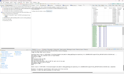

Hello.
We are using the s32k324 model now.
Among the example codes supported by nxp, you are using C:\NXP\S32DS.3.5\S32DS\software\PlatformSDK_S32K3\RTD\Crypto_TS_T40D34M30I0R0\examples\S32DS\S32K3XXX\Hse_Ip_AesEncAsyncIrq_S32K344.
I turned the code, but I got an error like the picture, so I don't know how to solve it, so I'm writing.

BusFault: An imprecise (asynchronous) data access error has occurred.
HardFault: A fault has been escalated to a hard fault.
This is an error I'm having right now.
I'm attaching the code as well.
Please tell me how to resolve it.
Thank you.

Hi @bohee2
I noticed that you mentioned using an S32K324 device, but it appears you are loading an example code intended for the S32K344 device. Please follow these steps:
  1. Generate a new project with the correct MCU, specifically for the S32K324.
  2. Copy the application source files from your existing project to the new one.
  3. Transfer any customizations you made to the project properties (e.g., configuration settings, peripheral setup, etc.).
If the issue persists, could you try attaching to the running target instead of loading the executable? This will allow us to pause and inspect the memory address at which the MCU is running. If the MCU is located at memory address 0x20400100 or similar, it indicates that the device is in recovery mode.
BR, VaneB
