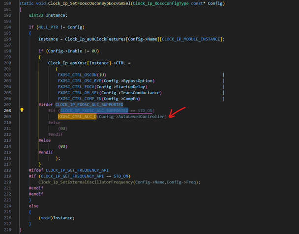

Hello.
How can I set FXOSC - CTRL[ALC_D] enable or disable on S32DS configurator?
I can't found that option on S32DS configurator.
Sean

Hi ssean,
Unfortunately, the ALC seems not a supported function so this bit can't be enabled.
To refer this ALC bit of FXOSC CTRL register, you can try to read this part of driver: Clock_Ip_SetFxoscOsconBypEocvGmSel
Thank you,
Nam.
