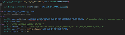

Hello NXP team,
We have configured Adc Timeout Method  as a OSIF_COUNTER_DUMMY so the  TimeoutTicks is taking the value as 0.
So Before doing the ADC_init() its going to the Adc_Sar_Ip_Powerdown() state because of Timeout.
But if I change the TimeoutTicks value as 1 manually in the plugins (Adc_TS_T40D34M20I0R0\src\Adc_Sar_Ip.c) its doing the ADC_init() operation.
How to proceed this TimeoutTicks.Please help on this ...
1,625 Views
CongDang
The "Adc Timeout Method' selects timeout method for Adc. And the "Adc Timeout Value" selects timeout value that is used for preventing endless loops.
In your case, I guess you configured Adc Timeout Value = 0, so you will get TimeoutTicks=0 in this case.
Please refer description on the nodes or read UM to get more detail
