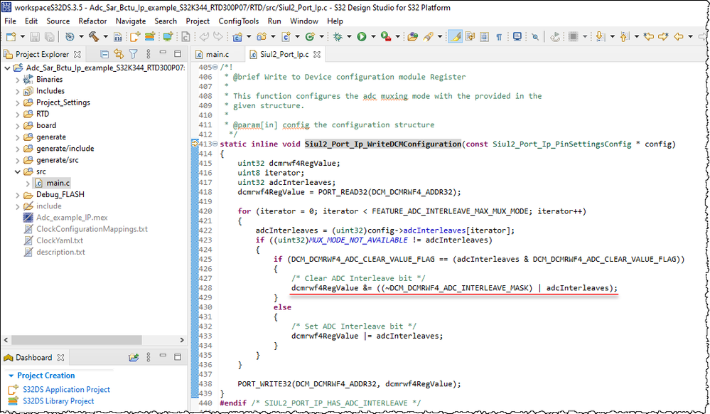

Hello.
I have problem with use S32K312, ADC0_S9
I read below articles.
https://community.nxp.com/t5/S32K/S32K344-ADC-HAS-ADC-INTERLEAVE-problem/m-p/1548855
https://community.nxp.com/t5/S32K/S32K3-ADC-Channcal-configure-problem/td-p/1527680
My RTD version is 2.0.1 (Released 7, July, 2022).
Which RTD version fixed that problem?

As I know this bug should be fixed in RTD_4.7_S32K3XX_3.0.0_CD04. But I did not install this version. I have install a new version S32K3_M27X Real-Time Drivers Version 3.0.0 P07. I can see that Siul2_Port_Ip_WriteDCMConfiguration has changed.
By the way, those S32K3 RTD 3.0.0 should be installed in S32DS v3.5. That means you need to install S32DS v3.5 instead of updating RTD in v3.4.
