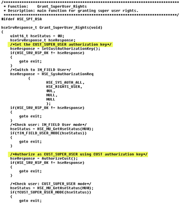

Further super user privileges are required to install the SMR. I copied this function from the template engineering. And this function also returns the correct value when the code runs. But the SMR is never installed. The variables I need to use I have put in the no cache address. The CMAC has been generated successfully. Is there anything else to pay attention to?

lukaszadrapa
What's the life cycle?

youxi
Hi @lukaszadrapa
I need your help. The current LC is CUST_DEL. Which LC can install the SMR

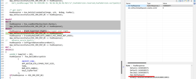

youxi
I haven't changed any of these functions and they run successfully.

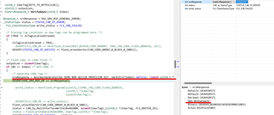

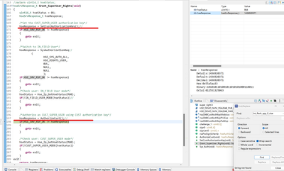

youxi
However, the smr still cannot be installed successfully
