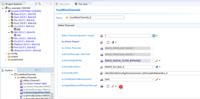

hello
AUTOSAR  4.4 V2.0.1 RTD ,S32K344 , EB
when capture pwm (period and duty ) signal using interrupt in ICU module , it is ok .  the period and duty data are correct .  In this case, the configuration item "IcuSignalMeasureWithoutInterrupt" is dsiabled, like the following picture
it is large resource consumption when using interrupt , so i try to enable the configuration item "IcuSignalMeasureWithoutInterrupt" ,  but the captured pwm (period and duty ) signal are abnormal , the data is jumping .

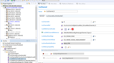

The question are:
1. when using polling in ICU , it must use/configure DMA meanwhile?
2. for capturing the pwm correctly, the following usage is all right ?
    a, interrupt ( "IcuSignalMeasureWithoutInterrupt" is disabled)
    b, polling only ("IcuSignalMeasureWithoutInterrupt" is enabled), It isn't necessary to configure DMA
    c, polling ( "IcuSignalMeasureWithoutInterrupt" is enabled ) and DMA
may you share some demo about ICU (capture the pwm using polling only, polling and DMA )
following codes are used in test :
initial::::Mcl_SetDmaChannelCommand(0, MCL_DMA_CH_ACK_ERROR);Icu_Init(&Icu_Config_VS_0); Icu_StartSignalMeasurement(IcuChannel_0);
period calling : Icu_GetPulseWidth(IcuChannel_0);

1. If you use Icu in polling mode, you can select to use either Dma or non-Dma
2. These 3 way are correct
