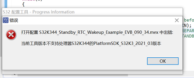

How to solve the following error?

Seems that you did not follow the steps "3.1 Generating the S32 configuration" of description.txt.

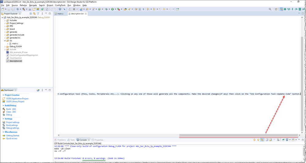

3.1 Generating the S32 configuration.png3.1 Generating the S32 configuration.png
click on the S32 Configuration Tool Update Code button.pngclick on the S32 Configuration Tool Update Code button.png
Before running the example a configuration needs to be generated. First go to Project Explorer View in S32 DS and select the current project. Select the "S32 Configuration Tool" menu then click on the desired configuration tool (Pins, Cocks, Peripherals etc...). Clicking on any one of those will generate all the components. Make the desired changes(if any) then click on the "S32 Configuration Tool->Update Code" button.

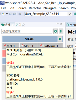

adc_sar not found in the toolchain IDE project. Project will not compile.pngadc_sar not found in the toolchain IDE project. Project will not compile.png

1260784871
how to solution?
2,375件の閲覧回数
Robin_Shen
That project is base on S32K3 RTD 0.9.0. Did you install that old version RTD? You may need to offline install it. Download RTD from S32K3 Standard Software
