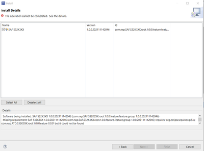

we have downloaded the S32K3 safety framework evaulation version library, when we are trying to install the same in s32ds config tool using "S32K3_SAF_1.0.0_EVAL_DS_updatesite". we are facing issue and we are not able to add those components in S32DS config tool.
Below is the error we are facing,
Cannot complete the install because one or more required items could not be found.
Software being installed: SAF S32K3XX 1.0.0.202111142046 (com.nxp.SAF.S32K3XX.root.1.0.0.feature.feature.group 1.0.0.202111142046)
Missing requirement: SAF S32K3XX 1.0.0.202111142046 (com.nxp.SAF.S32K3XX.root.1.0.0.feature.feature.group 1.0.0.202111142046) requires 'org.eclipse.equinox.p2.iu; com.nxp.RTD.S32K3XX.root.1.0.0.feature 0.0.0' but it could not be found
Could you please help us in getting this resolved.

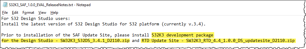

I have not install it before. According to the S32K3_SAF_1.0.0_EVAL_ReleaseNotes.txt:
Prior to installation of the SAF Update Site, please install S32K3 development package for the Design Studio - SW32K3_S32DS_3.4.1_D2110.zip and RTD Update Site SW32K3_RTD_4.4_1.0.0_DS_updatesite_D2110.zip
Have you install these two packages?
I am trying to install it. But I have install S32K3 RTD2.0.0(not RTD1.0.0) before, so S32K3 development package for the Design Studio has been installed. If the S32K3_SAF_1.0.0_EVAL_DS_updatesite is Offline Install in Extensions and Updates, it will automatically install dependent packages.
If still failed. Please 1st update S32 Design Studio Platform package and S32 Design Studio Platform Tools package, 2st update S32K3xx development package, 3st offline install SW32K3_RTD_4.4_1.0.0_DS_updatesite_D2110.zip , 4st offline install S32K3_SAF_1.0.0_EVAL_DS_updatesite.zip.
