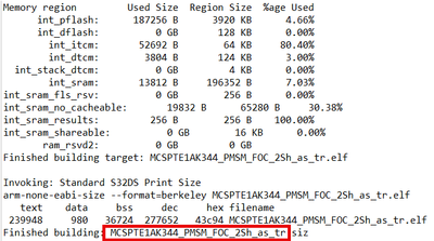

Can you tell us the following -
  1. For the example codes MCSPTE1AK344_PMSM_FOC_2Sh_as_tr and MCSPTE1AK344_PMSM_FOC_2Sh_ll can you tell the RAM and FLASH usage?

A2. Our motor control examples shows how to implement FOC or 6-step commutation control. We do not provide automotive traction inverter software. Sorry for the inconvenience.

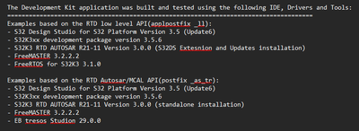

_Leo_
It is correct, MCSPTE1AK344_SW.exe file include all the provided project examples and documentation:
Additionally, I recommend you to consult the MCSPTE1AK344_ReleaseNotes.txt file before install IDE, Drivers and Tools in order to match specific versions:
And yes! Project examples are editable, just AMMCLib is provided in two versions (both of them works with the provided examples):
Hope it helps you.
