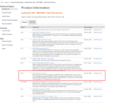

Hi NXP:
currently, we're going to initialize FS26(Safety System Basis Chips) in our project,
and also found SBC/PMIC Real Time Drivers website,but we are not sure which drivers for us.
please help us,thanks.
summary what we need condtions:
1.Non-AutoSAR SBC/PMIC Real Time Drivers for current environment description as below.
2.where I can download FS26 inistial code or sample code.
current environment description:
MCU:S32K312/100pin
S32DS Product:3.5.0.202207261815
RTD S32KXX:RTD5.0.0.202407261948
SW32K3_FreeRTOS_11.1.0_5.0.0_CD1_D2409_Example Project
Automotive SW - SBC/PMIC - Real Time Drivers:
https://nxp.flexnetoperations.com/control/frse/product?entitlementId=150315291&lineNum=1&authContact...

PetrS
you should select  SBC FS26 R21-11 4.0.0 package

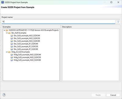

Read package release note document to know how to install it into S32DS.
after successful installation you can refer to available examples, but there is not directly for S32K312
