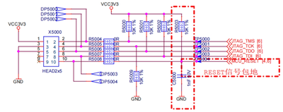

10,979 Views
longfeiwang
The target board is in the offline test state, and the Jtag is not connected. The output of the error code is matched and located through the CAN printed message information. The same error basically occurs once a day.

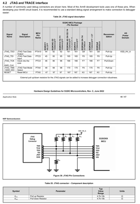

lukaszadrapa
Do you follow the recommendations from hardware design guide? Are there pull resistors on JTAG signals?
Lukas

longfeiwang
yes follow the recommendations:

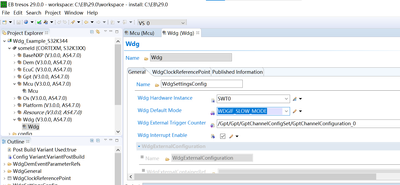

longfeiwang
The problem should have been resolved. After initializing the watchdog in S32K3, setmode was not called. When I called setmode(wdg_43_Instance0_ etMode(WDGIF_SLOW_MODE), the reset did not occur again. Will the process of initializing the watchdog not configure the working mode?

lukaszadrapa
Yes, Wdg_43_Instance0_SetMode() should be called at the beginning.

WeoWang
Hi Lukas,
I have a question, in the wdg example(C:\NXP\SW32K3_RTD_4.4_R21-11_3.0.0_P01_HF02\eclipse\plugins\Wdg_TS_T40D34M30I0R0\examples\EBT\S32K3XX\Wdg_Example_S32K344), wdg is configured in slow mode:
In main.c, I can understand that it switches to the fast mode by calling Wdg_43_Instance0_SetMode(WDGIF_FAST_MODE):
While in this case, the customer didn't want to use fast mode, why is Wdg_43_Instance0_SetMode(WDGIF_SLOW_MODE) still needed?
