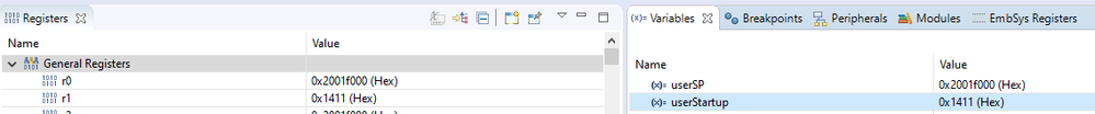

Dear NXP officer,
1) I try to follow the link to try on the S32K1xx bootloader
S32k144 boot loader
after download the code, I notice:
void JumpToUserApplication( unsigned int userSP, unsigned int userStartup)
/* Check if Entry address is erased and return if erased */
if(userSP == 0xFFFFFFFF){
return;
/* Set up stack pointer */
__asm("msr msp, r0");
__asm("msr psp, r0");
/* Relocate vector table */
S32_SCB->VTOR = (uint32_t)APP_START_ADDRESS;
/* Jump to application PC (r1) */
__asm("mov pc, r1");
So variable userSP and userStartup is not used inside this function? then what is the purpose to declare them?

1.
Actually, it is not true, the values of userSP and userStartup are used in the function. Their value is stored in the r0 and r1 registers.
Also, userSP is used for checking if the memory is erased at the address where you want to jump.
