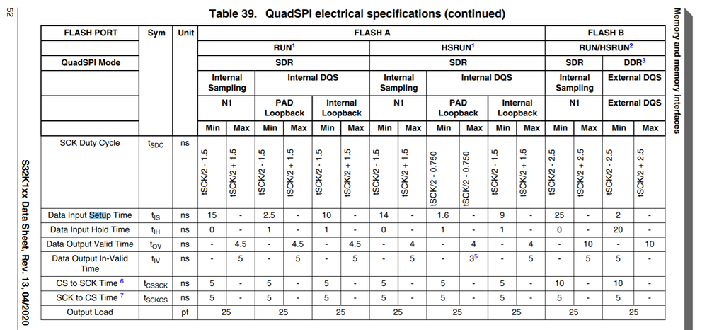

Hello NXP Team,
   we are using the S32K uC interface with various slaves. every slave has different setup and hold time requirements,
Do you have any standard calculations / Methods to ensure the slaves setup and hold time meet the uC requirement, we will not face any issues even worst case scenario?
1,301 Views
danielmartynek
Hello [email protected],
Unfortunately, there is no more information available.
The characteristics ware taken at the conditions specified in the datasheet 6.3.2 QuadSPI AC specifications.
And the min values of the input signal should be met.
