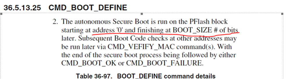

   1. if bootloader save in D-Flash ,it seems  that it is conflict with  the following function.
   2. when update firmware,  how does the code jump between APP & bootloader?

4. Yes, secure boot always uses start address 0. But the bootloader can be still protected by secure boot. It can be relatively easily solved by chain of trust. You can place simple piece of code to the first sector of flash. This can be protected directly by secure boot. This piece of code then can check CMAC of the bootloader in D-Flash. If it is correct, jump to the bootloader.

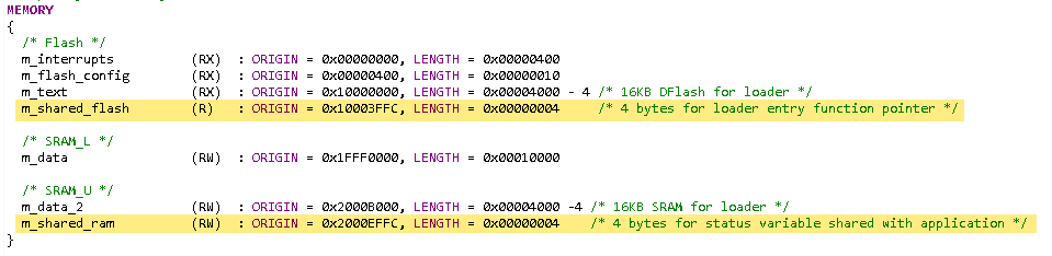

lukaszadrapa
Hi Kui,
well, I can see now that there are only binaries of the application.
But if you take closer look at the bootloader, you can see in linker file:
And then in main.c:
and
So, address 0x10003FFC contains pointer to function which you should call from application and address 0x2000EFFC contains status (return value) of that function which you are supposed to read after return.
In application, simply create a pointer to function:
void (*f_ptr)(void);
Load content of address 0x10003FFC  to the pointer:
f_ptr = (void(*)(void))(*(unsigned int*)0x10003FFC);
And call the function:
f_ptr();
When you return from the function, simply read status from 0x2000EFFC using a pointer.
You do not need to save/restore register content because you are still using C and EABI.
Lukas

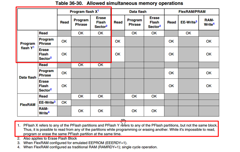

814420552
Hello Lukas,
      <1>My device is S32K146, according to reference manual, it should be support two partition for P-Flash?  is my understanding wrong as the following picture description?
     <2>As the last mail your description, S32K146 or 148 can not support application running when updating new firmware??
     <3>which SCENARIO (chapter "6.2 S32K146 use case".  SCENARIO (1)  and SCENARIO (2) )does the OTA demo code for in https://www.nxp.com/docs/en/application-note-software/AN12323SW.zip  ???  if this demo code fufil SCENARIO (1), thus whether has the demo code for SCENARIO (2)?
