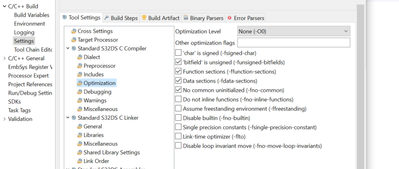

it could be caused by optimizations. I would check if the optimization level is set to 0:
Lukas
3,388件の閲覧回数
Saitej
Hello @lukaszadrapa
Thanks for the response
Currently we have zero optimisation's, Am able to break it in few trials as it is random.

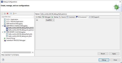

is OS Awareness enabled like this?
And if this doesn't help, is it possible to share the project, so we can try to reproduce the behavior on our side?
Lukas
3,347件の閲覧回数
Saitej
Hello @lukaszadrapa
Yes, OS awareness is enabled , it not helped us.
It's not possible to send the project , if you guide me will share all the logs with to debug the issue.
