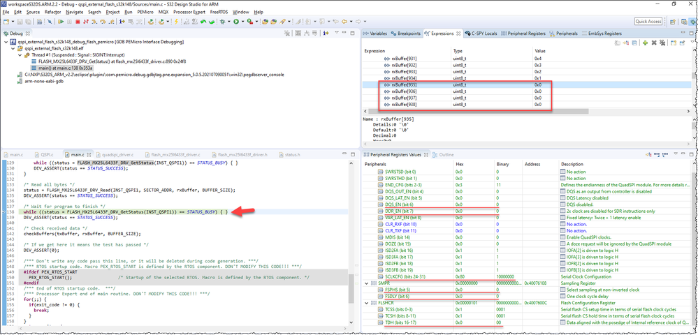

Using PLL, as shown, even 30MHz is too much....program stops and wait forever on last RX interrupt

After modify the S32K148EVB circuit and change the clock configuration, I encountered the same phenomenon you described.

Wait for program to finish 76MHz div2.pngWait for program to finish 76MHz div2.png
According to the description of the Data Sheet "Table 39. QuadSPI electrical specifications", the max SCK Clock Frequency of FLASH A PORT should be 38MHz when Internal Sampling is selected.
I got their feedback after consulting the AE team:
I re-appeared the issue you describled. After anslysis, this issue is not caused by the clock frequency. when you read data and the size is larger than 256 bytes, it will happen the overflow error. so it will pending in that line. if I reallocated the read API into the write process, which read 256 bytes every time, it work well. That means the maximum clock frequency can reach 38MHz. about the overflow error, I will test it in the newest version. if still exist, I will create a ticket in our system.
