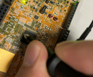

Senlent
Hi@Kallappa
      Can you try to test the PWM output pins of the MCU, as shown in the figure below.
      If you are using ftm_pwm_s32k148 example, please measure PTE21.
ftm_pwm_s32k142-PWM
There was a similar problem before.
If it still doesn't work, please let me know and I will test the example of S32K148EVB.
BR!
     Jim.
16,295 Views
Kallappa
Thanks for your quick response,
Currently, I don't have the Oscilloscope to check the waveform but I checked on the multimeter it is showing some values like 348 while duty cycle  uint16_t dutyCycle = 0xFFF; On pin .but as per the example DOC, the LED from the Board should glow right RED LED. it is not glowing.

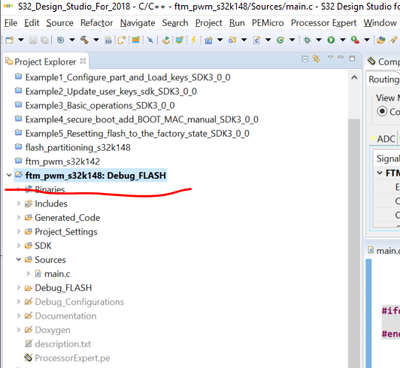

Kallappa
Hello I try to open the project in my IDE but it is showing the error related to SDK PFA for the same,
I am really new to this things please let me know how should I proceed in this and how I can update my SDK to yours one ,
16,207 Views
Kallappa
Thanks, @Senlent ,
The issue is with a version of the SDK and the IDE version, now i am able to run the example.

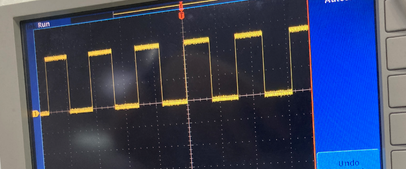

Kallappa
Hello @Senlent ,
yes absolutely, but somehow the delay is creating the problem in the PWM wave, PFA for the same
1. I put the duty cycle 50 % i.e 0x4000 with delay the waveform is showing properly on pin 21.
2. I put the same duty cycle and the change the delay is affecting the waveform.
PFA for Both scenarios,
16,149 Views

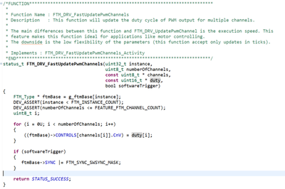

Senlent
Hi@Kallappa
   Ok, I understand what you mean, this does have an impact, because you update too fast. Under normal circumstances, when we change the PWM duty cycle, we need some delay time (I have not tested how much is needed, but I have tried to call it once in 1ms in the PID algorithm)。
 You can try to use this function, this may update faster, but it should also require a little delay time.
This is all I know, if you still have questions about this, you can post a new questions in the community.
BR!
      Jim,

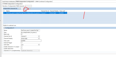

Kallappa
ok , got it,
 how to read the two duty cycles on two different pins for ex:
1:  FTM PWM channel 1 PTE21 (50 % Duty Cycle)
2:  FTM PWM channel 2 PTE22 (20 % Duty Cycle)
For Case two I added one more channel and I configured for a 20 % Duty Cycle,
and I check on the pin but I am not getting data, it will route the data to pin 22 via processor expert code generation processes, or do we need to route it explicitly? or I am only missing something ?
16,140 Views
Senlent
Hi@Kallappa
Step1.add channel 2
Step2.
BR!
       Jim,
