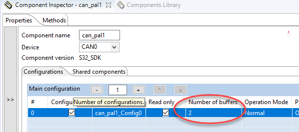

S32k146: How to configure Message Buffer in CAN for multiple CAN ID's. Is there any reference or example code that I can refer to for the configuration of MBs with classical CAN?

Hi Petr
I appreciate & thanks for your support.
After modifying the number of Rxmailbox to 13,  still  I am not getting execution in the callback. Is there any specific required to enable callback function?

shahenshah
Hi Petr
Thanks for your response.
CAN communication is working but still, I am not getting the in CALLBACK function.
The problem that I am facing right now, execution is not going in the callback function whenever I am receiving or transmitting any data using CAN0.
Whenever I add a breakpoint in the callback function mentioned below, the execution doesn't stop in callback function

shahenshah
Hi Petr
Thanks for sharing the detailed information.
I am using RX message buffers i.e. 10,11 & 12 and trying to install callback but i am not understanding where my code is going wrong? I am not getting execution in the callback.I am using LPtimer for setting sendFrame flag, which is working fine.
I have attached all the related files for reference.

PetrS
within CAN component increase number of used MBs, if you want to use MB12 set value to 13
