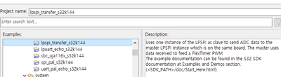

Software :      lpspi_transfer_s32k144  (S32DS Project Example)
                       --> Modified SW3 button interrupt function.
1) Firstly, I use S32DS sample example.

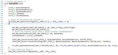

2) I attached 'button PTC13 interrupt '
In main( ) function , it is good working.
But, after when I push button SW3 , SPI was not work interrupt function in buttonISR(void).
I attached software source.
Please help me!.

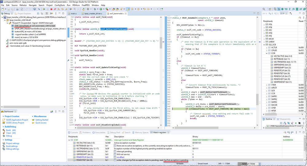

By debug your project, I find that it stuck at OSIF_SemaWait. The OSIF_SemaWait using interrupt of Systick, but the interrupt of Systick was pending.
Would you please configure the priority of PORTC(your button isr) or Systick. So that the interrupt of Systick is able to run.

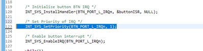

For example:
INT_SYS_SetPriority(PORTC_IRQn,1);

The Interrupt service routing should be a small non-blocking code, but you have a master blocking transfer function in your handler.
I would recommend to use interruption, or a flag in the handler of the interrupt to signal a new transfer.

It was work if I add below line.
