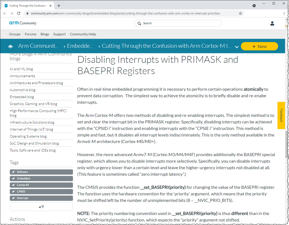

Hello, I have a question about the interrupt function process: If I don't need interrupt nesting, is there need add disable interrupt at the first of interrupt function, then add enable interrupt at the end of interrupt function? Thank you!

wanglijun
Hello Robbin, In the S32DS provided interrupt function, there is no interrupt disable and enable process. So it means enable interrupt nesting or disable interrupt nesting? Thank you!
7,641 Views
Robin_Shen
There is no register for enabling or disabling interrupt nesting. In addition, enabling and disabling interrupts is a register of the ARM Cortex core. I suggest you read this article: Cutting Through the Confusion with Arm Cortex-M Interrupt Priorities

wanglijun
Hello Robbin, I still can't understand. Does it mean if the interrupt priority is different, there is interrupt nesting? Best Regards, Wang Lijun
7,622 Views
Robin_Shen
Hi wanglijun,
The default interrupt priority are set to 0, so there should no interrupt nesting happen unless you reconfigure the interrupt priority by using INT_SYS_SetPriority() function.
