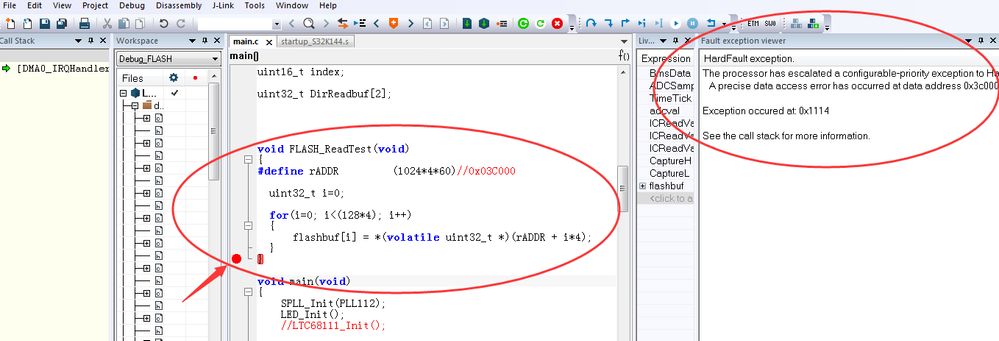

QQ图片20180416163958.png  The debug pic
S32K144 PFlash address range :  0-0x0007FFFF

(1)IDE:IAR 8.20.2
(2)HARDWARE:S32K144EVB-Q100
The problem may be ?
Thanks a lot !

The address 0x3C000 is the first one you are reading. So the first reading triggers the exception. Have you tried another address?
What is your clock configuration?
