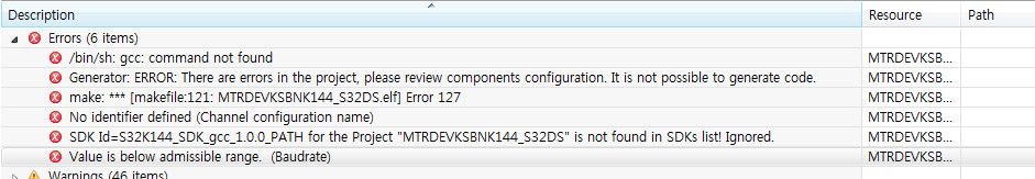

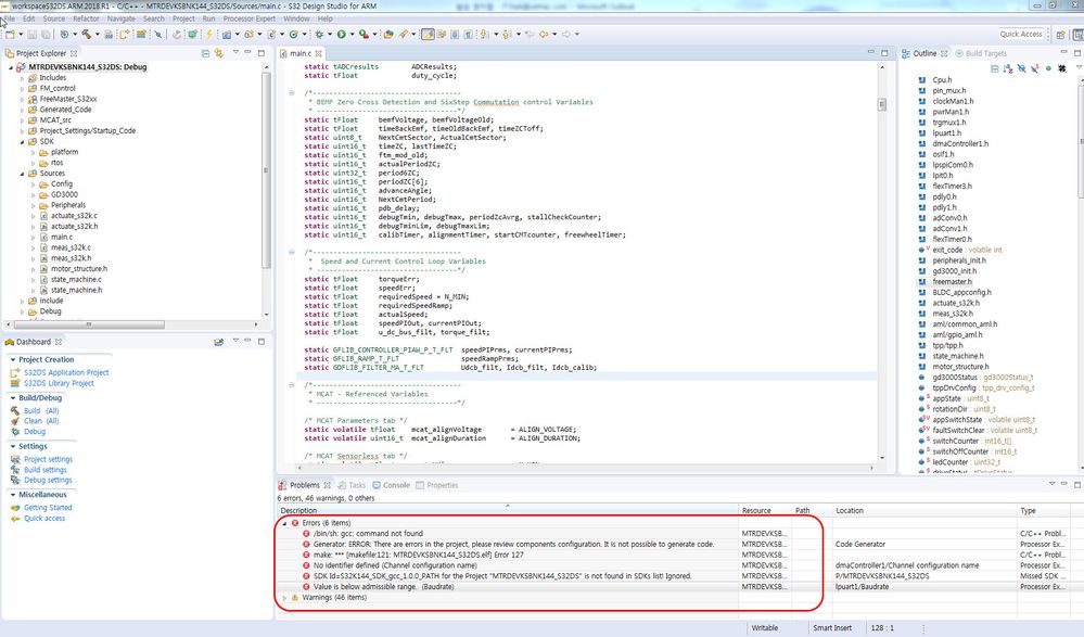

I tried S/W of MTRDEVKSBNK144_S32DS in S32DS.
but I can't compile as below.
What's problem?
Please help for this.
Thanks.

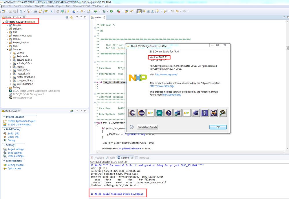

Daniel_Popa
Hi JT,
That SW is not ported to the latest S32DS 2018.R1. You need to use the version highlighted in the release notes associated with.
If you wish to have a version that works with the latest DS please download it from here: http://www.nxp.com/webapp/swlicensing/sso/downloadSoftware.sp?catid=MCAT
Hope this helps!

jtpark
Dear Daniel,
Thank you for your quickly reply.
I solved it.
Thanks.

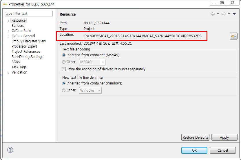

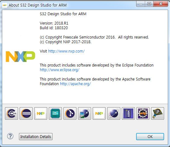

jtpark
Dear Daniel,
I matched S/W and DS by 2018.R1.
Thanks.
