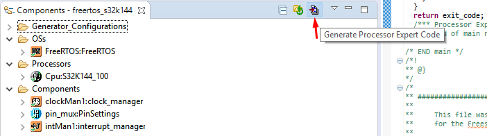

Hi Jorge,
You need to "Generate processor expert code" before compilation.
As far as I know we don't have any FreeRTOS example without SDK.

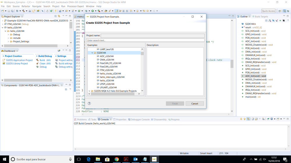

You are right, but this example was programmed using a different syntax. I tried to compile it, but it doesn't work. I realised that some of the examples were programmed using a new syntax and some of them with an old one using different libraries and configuring the platform in a different way. So, is there any RTOS example using the new syntax? It could be just the same example.
Jorge

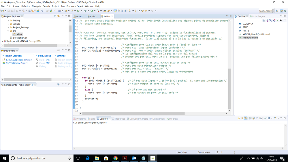

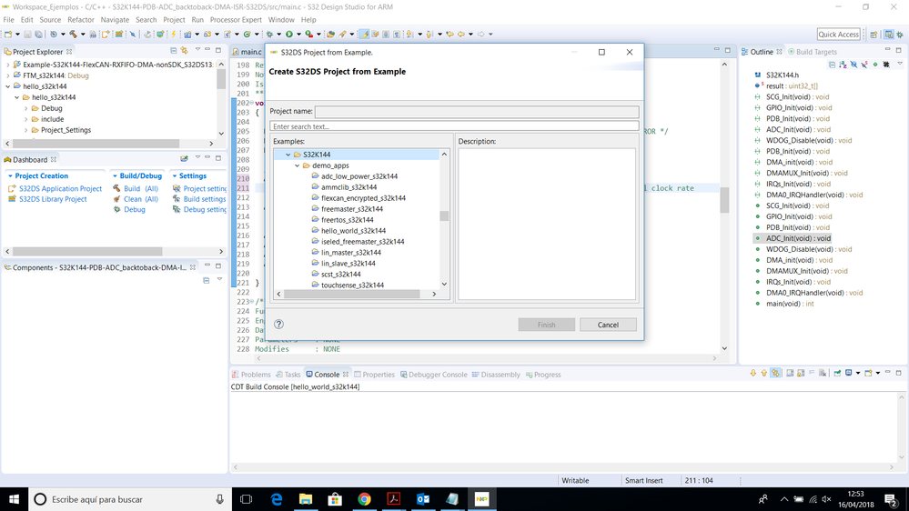

 I mean that i use these examples: pastedImage_1.png
Not these ones:
They use different libraries like cpu.h and basic C libraries. While i am using just s32k144.h library. The functions used on each type are different and you must add a processor in order to compile your code, while i am not doing anything of that.

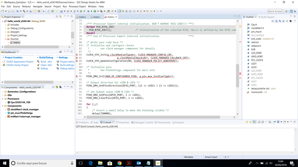

About the syntax:
What i use.
What is used for the freertos example.
Jorge

Hi Jorge,
