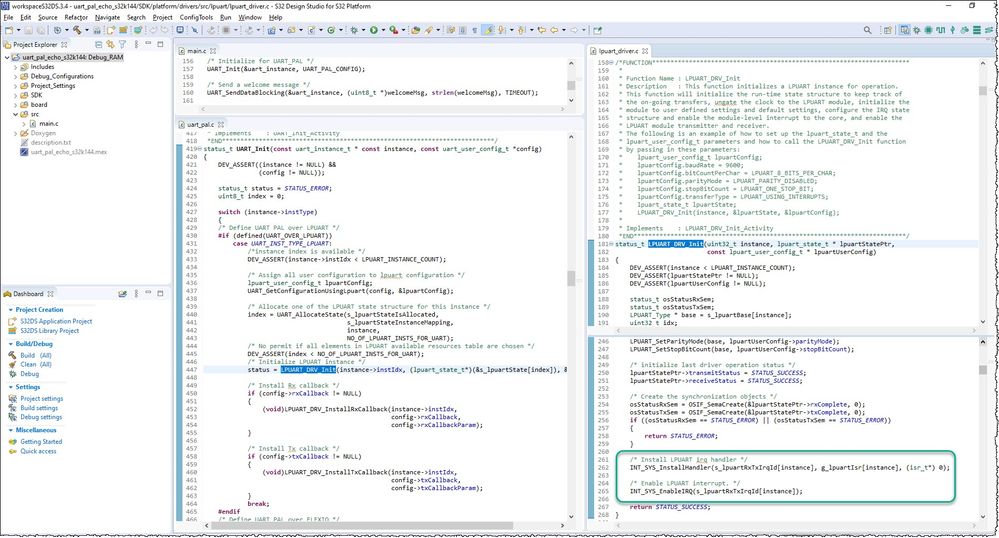

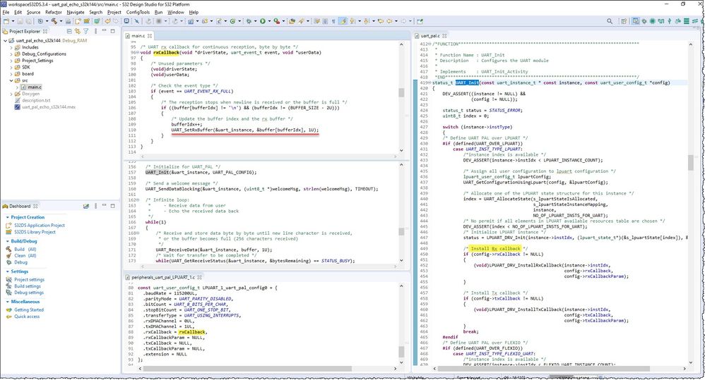

By the way, I don't know the feature of this function:
Usart_Receive_Data_Interrupt(&uartPal1_instance,&RS_DataToRead,RS485_Bytes_To_Read);
If you are using UART PAL, then UART_Inint will install LPUART isr handler and enable LPUART interrupt in LPUART_DRV_Init.
Please refer the rxCallback of uart_pal_echo_s32k144.
