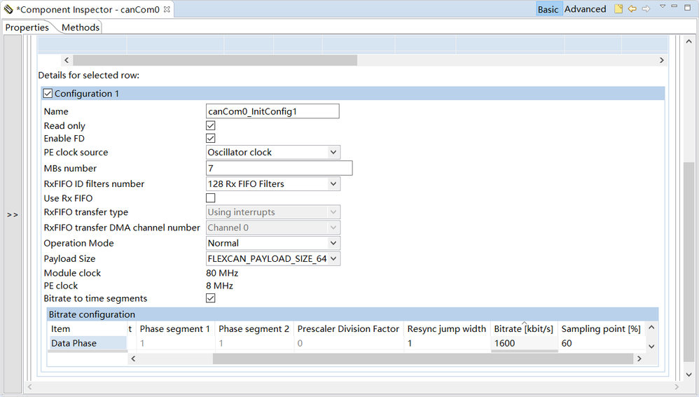

gravity_one
hello,
set Data phase to MAX 1600kbit/s by ProcessorExpert.pe
2,173 Views
PetrS
use crystal with higher frequency or select system clock as PE clock source.
BR, Petr
