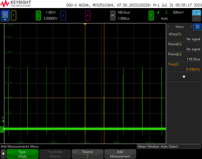

MattSki
I just received a new board and am trying to troubleshoot an issue. On power on to the board, it seems that the processor is stuck repeating a reset. I have included a screenshot of what I am seeing on a scope trace of the reset pin (pin 97). I cannot figure out what could be causing this, and was hoping someone here would have any ideas.
Thanks in advance!

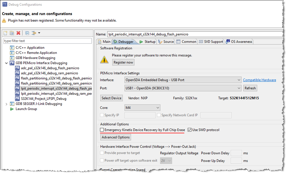

Robin_Shen
Hi MattSki,
After mass erase through the Debug Interface(SWD/JTAG), you should be able to program the chip. If you are using S32DS, please check Emergency Kinetis Device Recovery by Full Chip Erase.
Emergency Kinetis Device Recovery by Full Chip Erase.pngEmergency Kinetis Device Recovery by Full Chip Erase.png
If still not able to connect MCU, then I am afraid you need to use the P&E Recovery Utility.

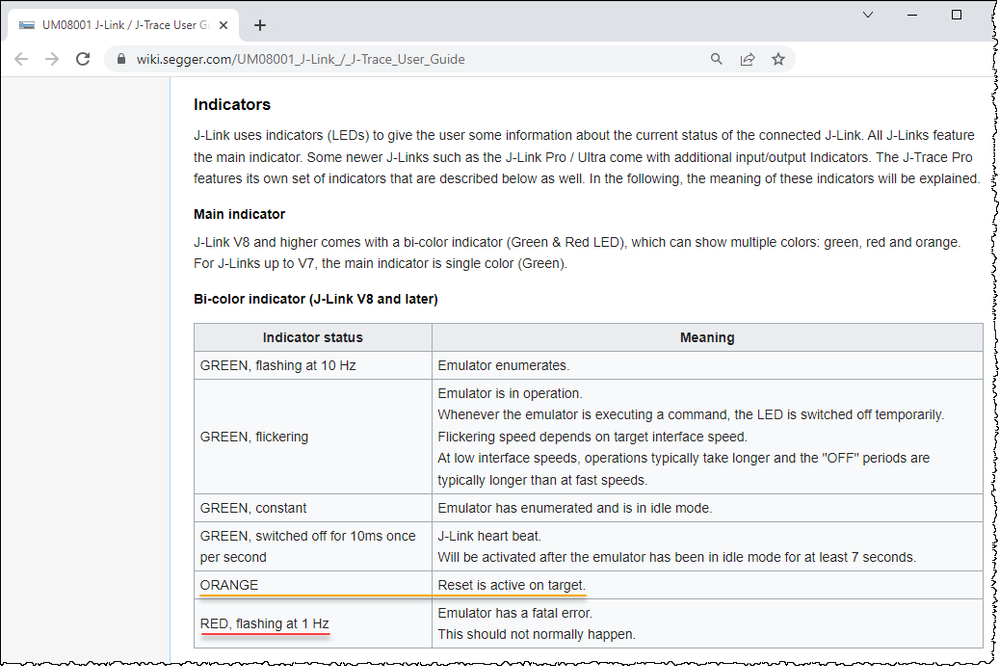

Robin_Shen
If the S32K144 stuck in reset loop, then the Bi-color indicator (J-Link V8 and later) should be ORANGE.
Bi-color indicator (J-Link V8 and later).pngBi-color indicator (J-Link V8 and later).png
Would you please show me the screenshot of Segger J-Link Commander after you input those commands?
Did you type "connect" to establish a target connection?

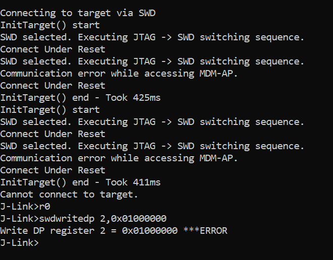

MattSki
Hi Robin,
I am unable to connect to the target when the reset pin and VDD are connected. I have included a screenshot of the commander window.
Thank you,
Matt
5,045 Views
Robin_Shen
Connect to the target when the reset pin and GND(not VDD)are connected.

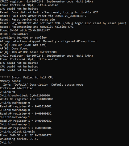

MattSki
My mistake. Here are screenshots of Commander.
Thanks.
5,009 Views
Robin_Shen
The values of MDM-AP Status Register and MDM-AP Control Register looks ok. And PEMicro can be used for program and debug normally. Strange. What is the version of SEGGER J-Link software? Have you consulted SEGGER's technical support?
