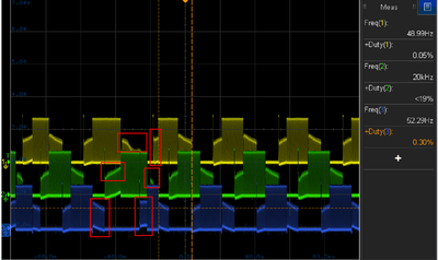

Yes am using different sensorless bldc motor. The motor startup is working fine, it reaching the 800RPM also. If i let it run for >= 800 RPM continuously it runs fine, But, after some time it stopped and  shows stall error. Sometimes, after startup immediately it stopped, sometimes continuously running for less than a minute and stall error occurred then stopped. I believe the cmt count parameter is for open loop startup. its fine for initial startup and spinning.  I saw the width variation in the back-emf waveforms. So am thinking that this waveform width variation is causing the stall error? I attached the back-EMF waveforms.

Now I understand that the described issue is rather related to a closed loop instead open loop.
From waveforms is clear that there is some issue and most probably the sw does not capture zero cross point correctly. I can see some deviation already on the second "pulse" on the first waveform (E.g. the yellow ON part is too long). Maybe the issue happened soemewhere early.
Hard to say, what could be the reason.
Could you please share the technical spefication of the used motor and the parameters that you used (e.g. screeshot from MCAT or optionally BLDC_appconfig.h)?

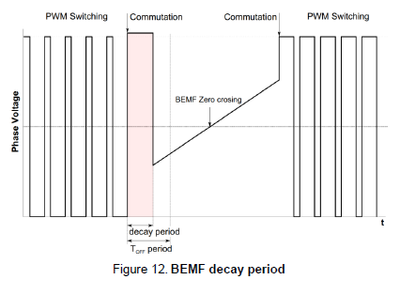

Idea: Maybe you may check the blanking time Toff (During this period, the BEMF voltage is not sensed or used for sensorless control - it filter the transient effects) and compare it with the waveforms.
