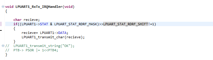

I want to enable the computer to send the data to the S32 MCU, and then print it to the computer terminal. I don't know if I have the correct writing below, I would like to give directions.
5,559 Views
PetrS
yes, it can be done this way.
See attached LPUART demo example with added RX interrupt.
BR, Petr

I was trying to do the same thing Receiving an RX interrupt but I can't make it work, I am able to send data through TX, interrupts just for RX and baudrate 115200. can you help if I am missing something please. I am using S32K146
I already enabled the Transmitter and Receiver and enable Receiver Interrupt.
