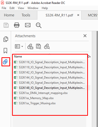

How to get the  IO Signal Description Input Multiplexing sheet for S32K148 microcontroller?
S32K148 reference doc is not attached with IO Signal Description Input Multiplexing sheet for S32K148 microcontroller
Hello Diana Batrioa
Can you help me to get the document as mentioned above?
4,744 Views
dianabatrlova
Please, download the Reference Manual and open it in the PC
https://www.nxp.com/docs/en/reference-manual/S32K-RM.pdf
the document can be seen in the attachment:
I hope it helps.
BR,
Diana
4,744 Views
systems1
Hello Diana
Sorry to report. In the suggested doc, the full description of pad description is blocked.
