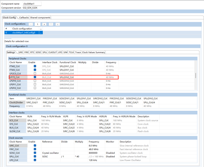

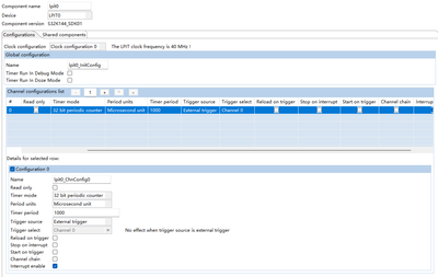

Hello EveryOne,
I usd SDK to config the LPIT, and delay 100ms to send command to slave IC,but I find the time interval is inaccurate, it is more than 100ms. I check the timer task, no redundant code is running, whether need to do other configure for the lpit module?

Robin_Shen
Please toggle a GPIO in LPIT interrupt and measure the period by using oscilloscope. I try to modify the lpit_periodic_interrupt_s32k144 SDK example and able to get 1ms when input Timer period 1000.

547416104
The issue is fixed, timer is holded by ADC autocalibration active.
