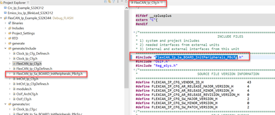

We team want to develop the project on S32K342. The version of IDE is S32DS V3.5 and the package of RTD is "SW32K3_RTD_4.4_2.0.2_DS_updatesite_D2211.zip". I attach a creenshot which shows the specific version I set up.
When we have finished the CT configuration and updated the code, we can not build it successfully. One of attached screenshots shows the problem. And we find that the content of it is totally same with another head file. If we replace "FlexCAN_Ip_Sa_BOARD_InitPeripherals_PBcfg.h" with "FlexCAN_Ip_Sa_PBcfg.h",it can be built successfully.

Hi@Hermit,
Below is my test result, everything works fine.
The RTD 2.0.2 FlexCAN module does not generate the file "FlexCAN_Ip_Sa_PBcfg.h".
