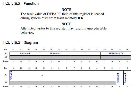

damiendusha
Hi Daniel,
Thanks, I have been able to verify the DEPART value, but I would like to ask about the EEERAMSIZE field in FCFG1[DEPART].
I can can setup D-Flash partitioning without any problems using the FLASH_DRV driver.

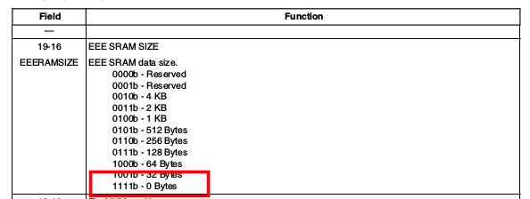

However, after rebooting the DEPART value is correct, but the EEESRAMSIZE reports as 0x02 (4KB).  I would have expected this to be 0x0F as per s10.3.11.10.4:
SIM->FCFG1 = 0xFF020000
It's worth noting, however, that the FCNFG[RAMDRY] report that Flex is available as traditional RAM only:
FTFC->FCNFG = 0x02
Is this the expected behavior of the device?  Is the D-Flash safe to use, even if the EEESRAMSIZE reports a value other than 0KB?

danielmartynek
Hi Damien,
The EEERAMSIZE bit-field doesn't get updated, it is always 0x2 (4KB). The NOTE is Section 11.3.1.10.2 (RM rev.9) mentions DEPART only. The FlexRAM can be used either as RAM or EEPROM, in either way, it is 4KB.
