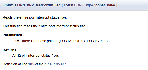

Instead of PORT_HAL_GetPortIntFlag(xx), you can use this:

What's the different between PORT_HAL_GetPortIntFlag and PINS_DRV_GetPortIntFlag, because there is no function PINS_DRV_GetPortIntFlag in my pins_driver.c file.
And here is the implementation of function PORT_HAL_GetPortIntFlag:
static inline uint32_t PORT_HAL_GetPortIntFlag(const PORT_Type* const base)
    uint32_t regValue = base->ISFR;
    return regValue;
Liu

Sorry, both the functions do actually the same thing.
You probably use an old version of the SDK.
I took the screenshot from the SDK RTM 3.0.0 documentation which can be found in the installation folder of the SDK.
...\NXP\S32DS_ARM_v2018.R1\S32DS\S32SDK_S32K1xx_RTM_3.0.0\doc\Start_here.html
If you start a new project, I would recommend the current SDK version.
