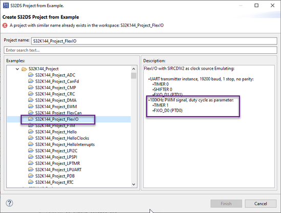

I get a project about using S32K144 to generate PWM by FlexIO module,and I have S32K144 EVB could try this project. But I meet some issues below:
1.
I have explored S32DS Example Project.But I can't not find the FlexIO_PWM project,even the Components Libary in Processor Expert still no flexio_pwm components.Can anyone show me the path in S32DS? Or share the example code for S32K144 EVB ?

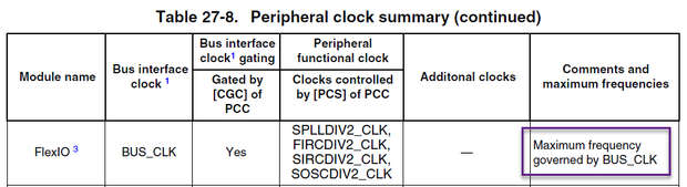

According to S32K RM,FlexIO module supports 2 chip modes,Run mode and Debug mode,but if I configure S32K as HSRUN mode,does it have some limitation of FlexIO PWM? or FlexIO module just not support HSRUN mode ?

1.
Unfortunately, there is no SDK FlexIO PWN driver.
But you can refer to the non-SDK example in the Design Studio:
2.
The FlexIO module is Fully-functional in HSRUN:

I got the project of FlexIO,and it works now!!
Then it can work under HSRUN mode.
