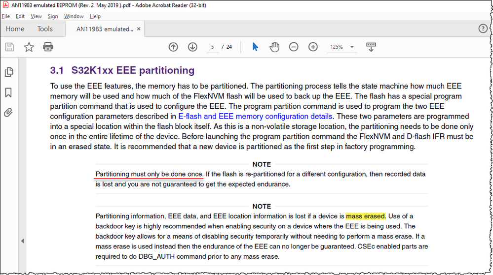

Robin_Shen
Partitioning must only be done once. Please mass erase the MCU.

Robin_Shen
How did you mass erase? SEGGER J-Link Commander and J-Flash is able to mass erase. Click Yes when prompts "Device is secure, Erase to unsecure?" should also trigger mass erase. After mass erase, you should able to program the chip again. If not, please check the values of MDM-AP status and control registers by refer to: Unbricking S32K146
