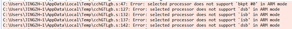

I use S32DS.3.4 to open the S32K342 example project, and the RTD version is 2.0.0. ,and the tool chain is GCC 10.2. I did not change anything, but the compile failed. I think some configure is not well, so where is the problem?

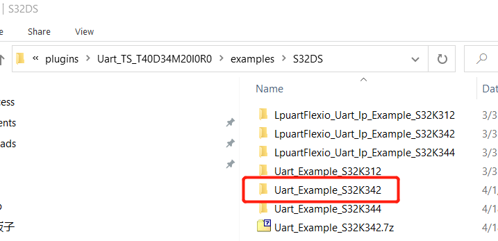

yes, I tried. At the beginning, the .mex file cannot be open, and I edited it by replace the line of<mcu_data>, the line now is like this:
<mcu_data>PlatformSDK_S32K3_2022_03</mcu_data>
 the middle is quite the latest sdks version I download last night.
but after generate code,  new error still occurs. IDE cannot find the header files.

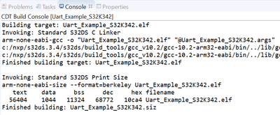

But today I realize that the directory I choose  when import the project is very import, don't choose the install path of SDK, but choose the path :
...S32DS.3.4\S32DS\software\PlatformSDK_S32K3_2022_03\SW32K3_RTD_4_4_2_0_0_D2203\Uart_TS_T40D34M20I0R0\examples\S32DS\Uart_Example_S32K342
Nothing need to be changed. It works well.
Thank you.

and here's the errors. Sorry for the topic cannot be re-edit. WeChat Image_20220418221702.png1073_109_1.25.png
