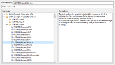

you can refer to demo examples in S32DS 2.2
This example follows https://www.nxp.com/docs/en/application-note/AN5413.pdf code, see chapter 2.9.

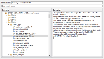

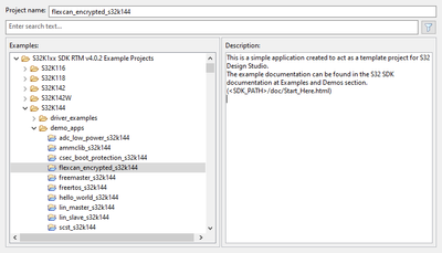

There is also SDK based demo
Similar SDK example is also in S32DS3.4

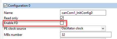

CAN FD is disabled by clearing MCR[FDEN] bit. In SDK it is done by unchecking "Enable FD" option in flexcan component.
Anyway , even if CAN FD is enabled. FlexCAN is able to receive and transmit messages in both CAN FD and CAN 2.0 formats.

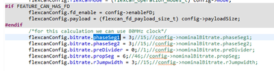

I wanted to know can bit time setting for 500KHz , and ctrl setting as per below snap for the same sample code,sys clk selected is 80Mhz
so what should i set for below register in the sample code such that the can communication can take place for 8Mhz Sclock (derived from above CTRL1 register setting) and 500KHz bitrate for Can communication.
In canpal flexcan sample code , i have done below changes , .enablefd=false, .length = 8, payload selected as 8byte and disabled the FEATURE_CAN_HAS_FD macro in the code.
Please let me know if any other register value needs to be updated for standard CAN changes and also confirm the CAN bite setting for register phaseSeg1, phaseSeg2,predivider,propSeg and rJumpwidth.

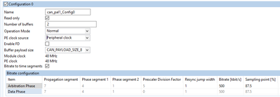

if using SDK do not modify driver code, rather do a setting in PE components
You can disable CAN FD, select PE clock source, and change desired Bitrate and sampling point. Bit timing segment will be calculated.
