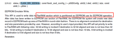

there some questions after i read the S32K-RM and s32kAPI document, hope someone give some advices,thank you ,hope your repy.

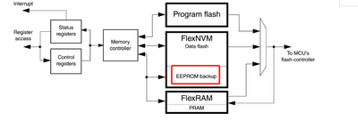

1>in the picture ,only the flexnvm could used for eeprom,but when i read the api document ,i feel so confused: the ee2prom is divided from flexnvm or flexram?
2>in the s32k-rm,if i want to use both eeprom and data flash ,how should i give value to the registers :
FCCOB4[3:0]      FCCOB5[3:0] ,the EEPROM Data Set Size is equal to EEPROM-backup Size (KB) ?????

but i still have  questions ,if i uesd the flexram as eeprom, when i have written to the 4k FLEXRAM,will it lose data after power off ????
then ,all will can do to operate flexnvm  eeprom backup is only to operate flexram ????

First of all, the data of FlexRAM will be lost when the power is off, but after power-on, you can set to automatically load the data of E-Flash to FlexRAM, you only need to operate FlexRAM, please do not operate the FlexNVM area that has been partitioned as backup.
