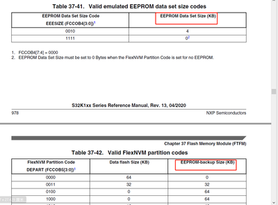

1>in the picture ,only the flexnvm could used for eeprom,but when i read the api document ,i feel so confused: the ee2prom is divided from flexnvm or flexram?
2>in the s32k-rm,if i want to use both eeprom and data flash ,how should i give value to the registers :
FCCOB4[3:0]      FCCOB5[3:0] ,the EEPROM Data Set Size is equal to EEPROM-backup Size (KB) ?????

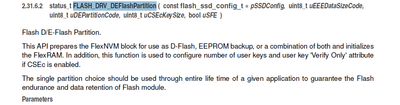

3>in other's examples , i want to know :in this example:
the flexnvm(64k) is totally used for eeprom????
the  space EEPROM size = 4 Kbytes is from where????
* Configure FlexRAM as EEPROM and FlexNVM as EEPROM backup region,
* DEFlashPartition will be failed if the IFR region isn't blank.
* Refer to the device document for valid EEPROM Data Size Code
* and FlexNVM Partition Code. For example on S32K148:
* - EEEDataSizeCode = 0x02u: EEPROM size = 4 Kbytes
* - DEPartitionCode = 0x04u: EEPROM backup size = 64 Kbytes
flashResult = FLASH_DRV_DEFlashPartition(&flashSSDConfig, 0x02u, 0x04u, 0x0u, false, true);

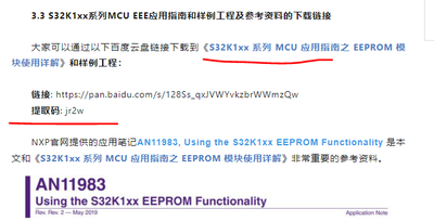

Hi@zq1
all you question can be found an answer in this application note.
https://mp.weixin.qq.com/s?__biz=MzI0MDk0ODcxMw==&mid=2247486584&idx=1&sn=3b8651b928edd19c642b17838a...
AN11983 is also a good guide to understand how EEPROMs work.

You can find the answers to these questions in the article I gave you.
First of all, the data of FlexRAM will be lost when the power is off, but after power-on, you can set to automatically load the data of E-Flash to FlexRAM, you only need to operate FlexRAM, please do not operate the FlexNVM area that has been partitioned as backup.
