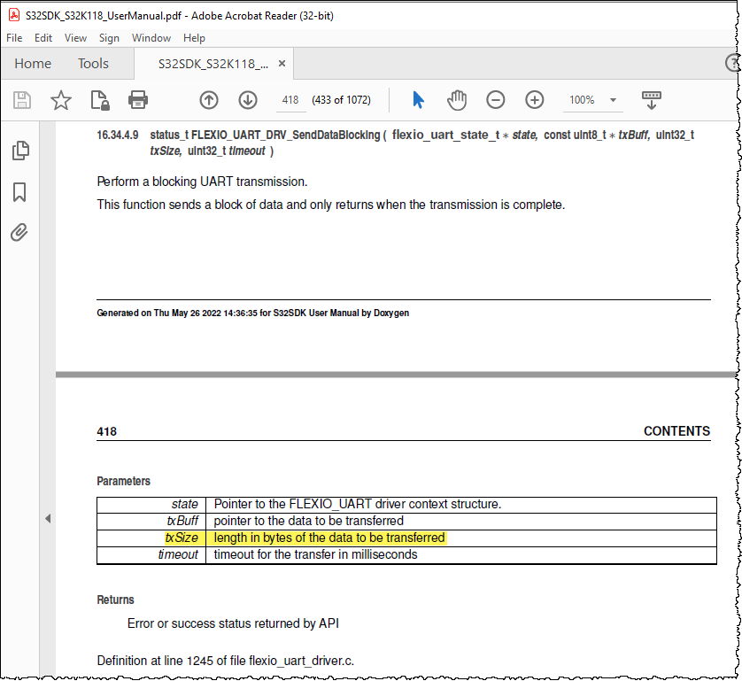

Please refer to the flexio_uart_s32k118 example in S32DS v3.4+SDK RTM4.0.3.
FLEXIO_UART_DRV_SendDataBlocking should be able to send several bytes. If you configure txSize=6, it can send these 6 bytes together.
Robin
