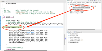

Hi everyone, I am currently learning the security startup of S32K344. Unfortunately, I did not find any relevant learning materials for my reference.So I decided to start with an project example,I found the project named Hse_Ip_AesEncAsynclrq_S32K344 in the routine and created it,but when I used the JLINK debugger to connect and DEBUG, Breakpoints are incorrectly located in the middle of the main program instead of at the beginning, and hardware interrupt errors occur irregularly during debugging.And there were also errors in the operation of the program.image.pngimage.pngimage.pngimage.png

When I used the JLink debugger of SEGGER to debug my program, normally the program would stop at the entrance of main function, but when it was actually running, the program unexpectedly stopped at the middle part of main function.
I would like to know how to set the debugging to return to normal working state
The breakpoint displayed in the Debug View is in the middle of the program, not at the beginning

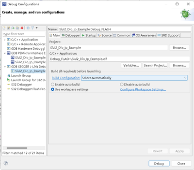

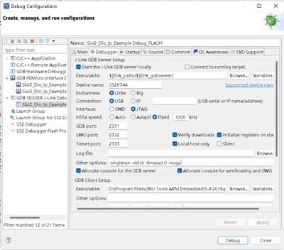

These are my debugger configurations
