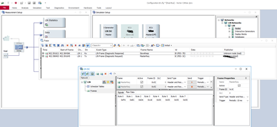

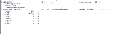

chaitanya_kalyani
Hello @PetrS ,
As per your suggestion I updated code and getting response but value is getting updated for only one time from next time getting value as 0x0.
I am sending data through CANOe
We are working on LIN based bootloader and we need to solve this issue ASAP.
Quick response highly appreciated.
Thank you in advance.

8,725 Views
pankajprasad100
Just modified the code while sending the Master request - frame, inside the code buffers are not updating same as @chaitanya_kalyani
But if I send 3D-frame I am getting the response.
Need help to  update the buffer while sending the Master request - frame.
