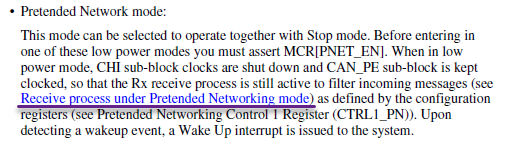

As I already mention, in VLPS, the FlexCAN cannot be a wake up source.
The port interrupt can be used and once the MCU is in RUN mode again, you can enable the FlexCAN module, the first message will be lost of course.
You can use the PN mode, but it works in STOP1/2 only.

The pretended network mode can be used in STOP1/2 but not in VLPS.

Unfortunately, I don’t have any experience with the Vector Geny tool.
I would recommend that you to go through the Vector documentation or to contact Vector.
The PNET mode is explained in the S32K1xx RM though.
