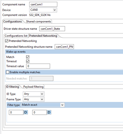

shindeu66
Can you please tell me,  How to get back in Normal RUN from STOP mode using CAN pretended network mode and Pin interrupt ?
Shinde Umesh
7,413 Views
danielmartynek
Hello shindeu66@gmail.com,
There is no Pretending mode wake-up example available.
But the FlexCAN SDK driver supports it:
The Example S32K144 RTC VLPS S32DS.R1 is using a Pin interrupt as a wake-up source, for instance.
You don’t need to reconfigure the CAN_RX pin to GPIO as the pin interrupt works in all the digital functions of a pin.
Just enable this interrupt (PORTx_PCRn) before the MCU enters VLPS.
